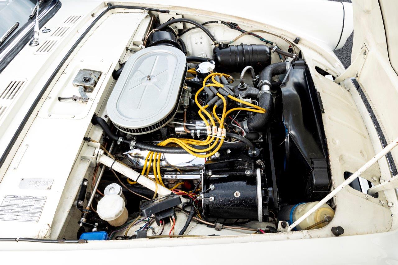

I recently replaced my Heater Matrix and didn't have any trouble with Air Locks on re-filling and re-starting my car.
Did you keep the Heater Valve open when running the Engine up to temperature?
I made sure the Matrix was nearly full of coolant and half filled the Header tank before restarting and warming the car up.
I then had to top up very slightly the Header tank once again.
I've connected up the overflow pipe off my header tank to a small 250ml bottle designed for a motorcycle and I keep this half full too (You can just make it out in this photo in the top right).
