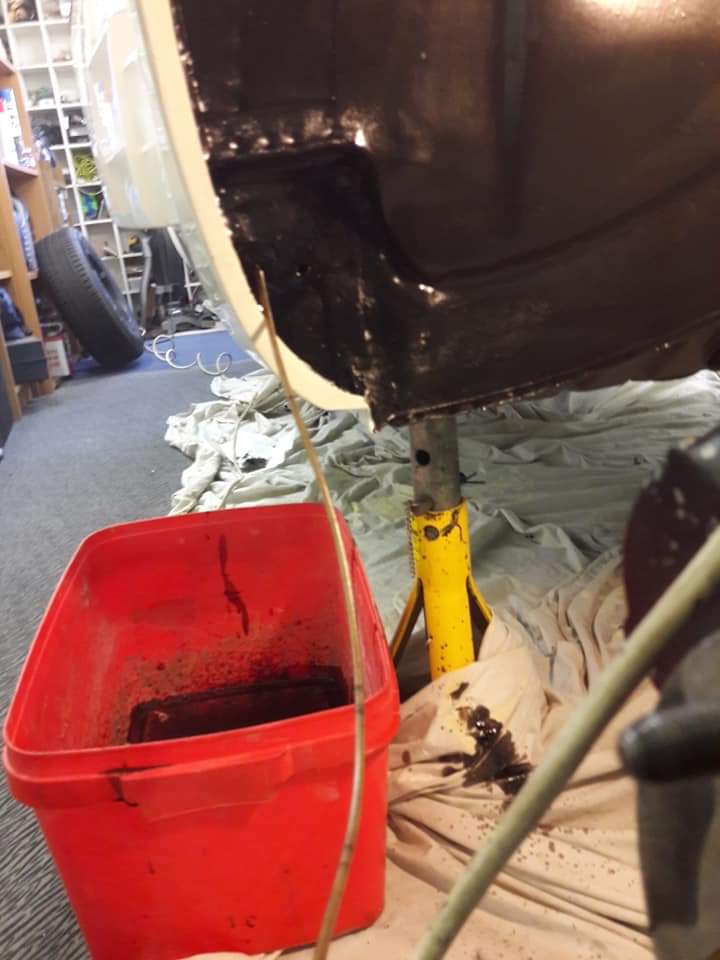

I'm doing a resto on my 1965 Tiger. And at the moment I’m stuck.
I’m looking for photos of the rear part of the front inner wing. Or guard.
The area behind the front wheel.
Mine has had rust repairs in this area, and there are patches over patches.
I’m finding it difficult to work out how the sheet metal is supposed to go together.
Thanks in anticipation.
Garry.

This is a picture I took when I was rust proofing my old tiger, I believe this is how they should look, it's not that clear but I hope it helps.
3. Bulkhead & Sill.jpg (52.52 KiB) Viewed 285308 times

Thanks Gary,
That’s the area. Mine has been patched and I don’t know how it’s meant to be attached to the sill.
Garry

The recessed section on the arch were it meets the sill is correct I believe.
I drilled some holes in the arch at low level so I could pump rustproofing fluid into the two Sill box sections.
