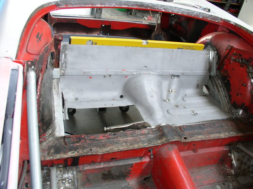

Post by Mal » Sat Oct 08, 2011 12:58 am
Ready to be welded back in place.

Post by gtsmrt » Sat Oct 08, 2011 7:30 am
Hi Mal,
Your boot has come up very nice. Were the holes in the corners behind the seat from rust or part of the repair process when replacing you rear rails? By the way, your mascot doesn't look impressed :) .
Post by Mal » Sat Oct 08, 2011 9:48 am
Robin. the holes are rust. He has to repair them once the rest is welded in as it won't fit if he does any more.

Post by Mal » Fri Nov 25, 2011 5:50 am
Boot is all welded back in place. Panhard rod bracket replaced.
Exhaust X frame holes enlarged. 8)
A bit of tidying up to do and the underside is ready for paint :D 8)

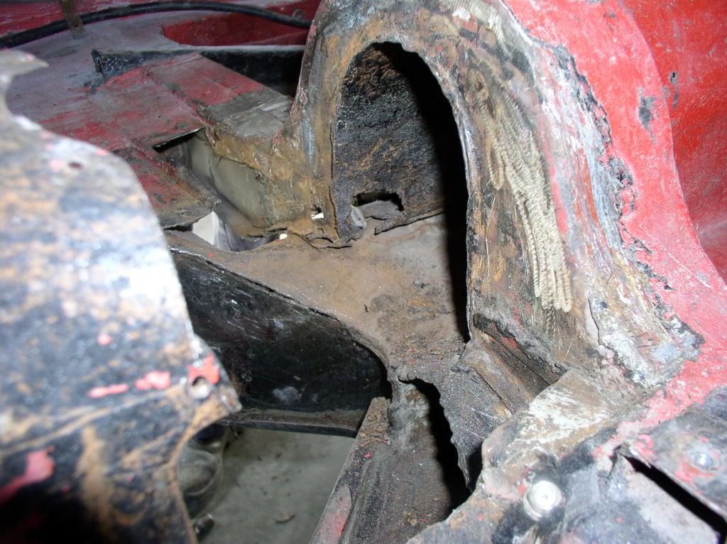

Post by Mal » Wed Jan 25, 2012 3:43 am
I spent a morning under the car removing old underseal and found some more rust :x . Panel man had to do this to get at it.
You can see a repair which has not been welded in properly to the left of the rust holes. That will need to be redone as well.
