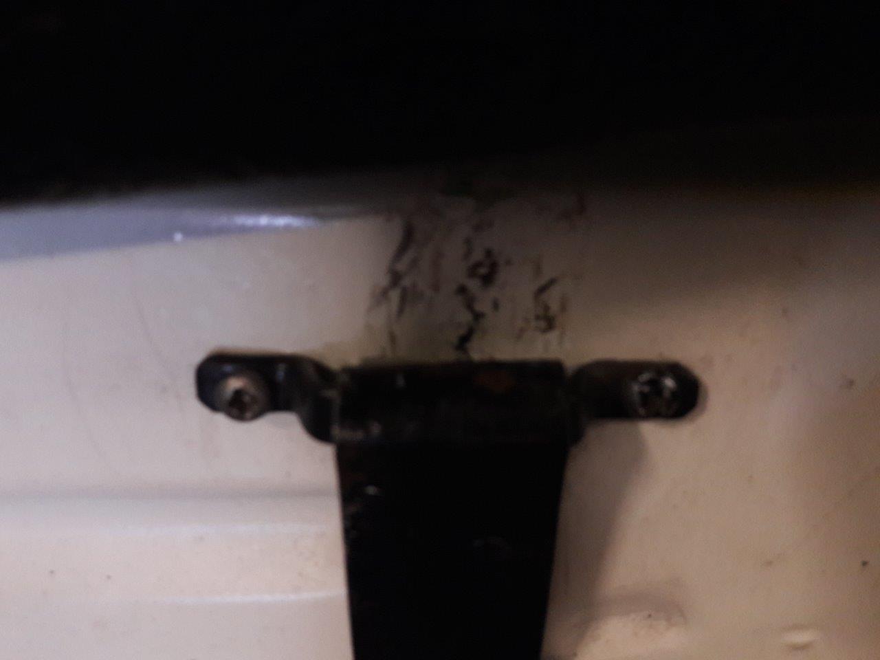

Brad. Don't think they are door parts, they look like the brackets the false boot floor hooks into. Two on the fear fire wall either side and one on the boot lid in the middle to hold up the floor when the boot and floor are up.
Re: Brads Tiger
think the bigger two on the fire wall smaller on the boot
Re: Brads Tiger
Your making great progress Brad
Here's a photo of one of the brackets on the Firewall on my Tiger, no idea if these are original though?
I have no bracket on the boot, the hook on the rubber strap simply clips onto the boot lid support pressing, again no idea if this is original.
