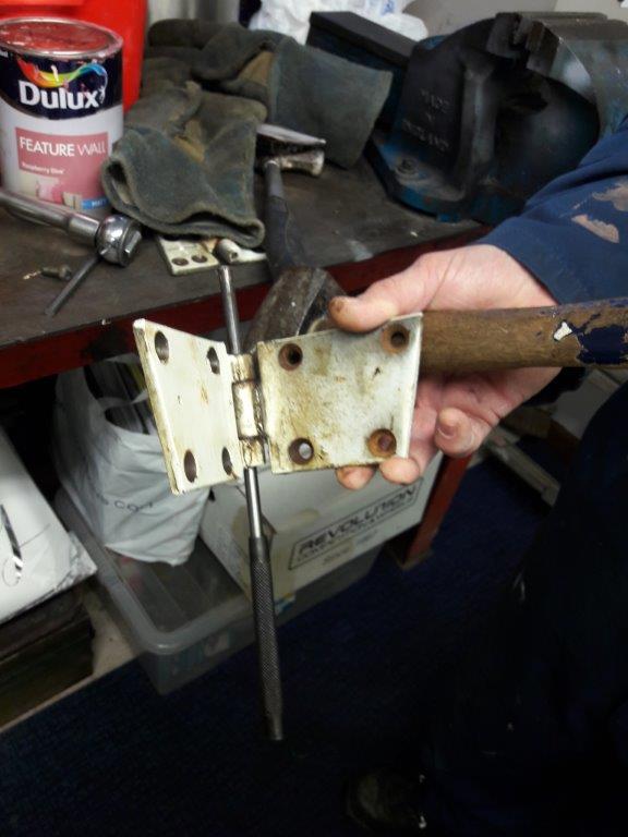

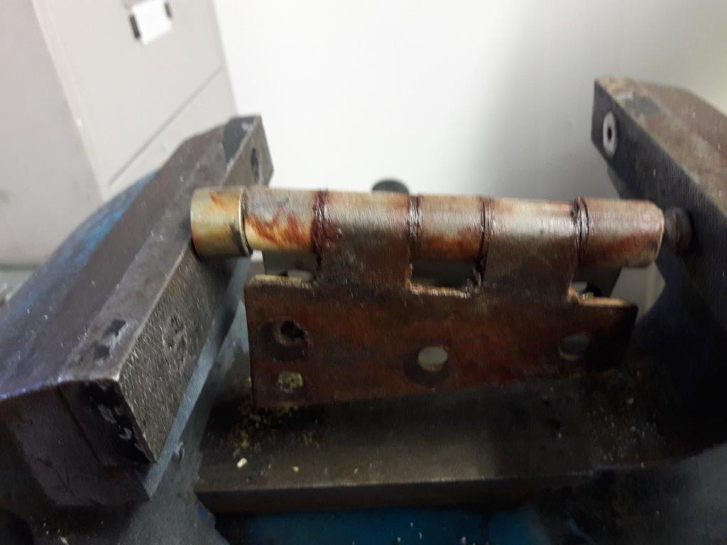

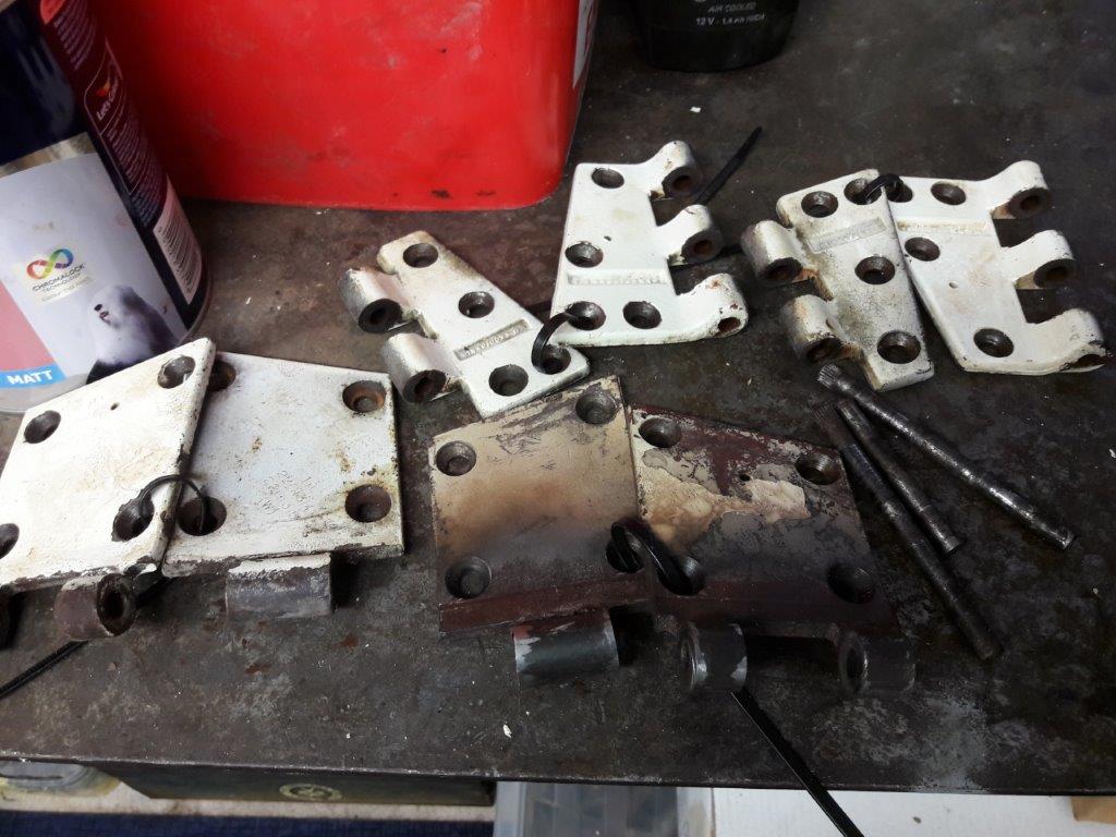

I managed to get some help at the Weekend with removing the doors, we managed to remove the Hinges from the doors with no problems.
We also managed to drift out 3 of the old Pins from the Hinges with the use of my Large Bench Vice for two of them and a large Hammer and Drift on the third.
The fourth Hinge (Passenger Side top) was a swine though!!
Even with the use of Heat and an even larger Hammer and Drift no joy, it turns out the pin had snapped near the top, so with careful use of a junior hacksaw to cut the pin, it was drifted out in 3 sections.
I need to do some careful measuring but I reckon the bottom hinges are not too badly worn and 8mm pins should be OK, however the top ones (The passenger side in particular) are badly worn and may need line boring out 9mm or even 10mm to get matching pins to be a tight fit.
Not sure if this will weaken the hinge too much and a better option is secondhand hinges, any advice welcomed?

Some Photo's attached of the Hinges?
- Attachments
- Pins Out.jpg (117.35 KiB) Viewed 43692 times
- Drifting Drivers Top Hinge Pin.jpg (50.62 KiB) Viewed 43692 times
- Pressing out bottom hinge Pin.jpg (59.9 KiB) Viewed 43692 times
Re: Door Hinge Pin Replacement
If you ask me line boring up to 9mm should work but for more I'ld rather look for better condition replacement hinges. Regard yourself very lucky that you could drift out the pins on 3 of them...

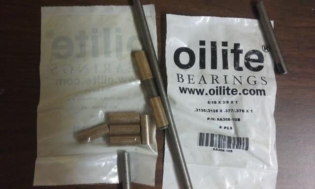

Another option is one of these Oilite bush and pin kits, unfortunately I'm struggling to source a supplier in the UK?
I have purchased some hardened 5/16" diameter steel rod, so should be able to source some similar Oilite bushes in the UK.
I've got an Engineer friend I'm seeing at the weekend, will see what he advises?

Bushing/oilite sounds a very very good idea to me. Where did you get them from ? Are they sintered or made from brass ?
They are Oil Impregnated Phosphor/Bronze I believe?
I haven't ordered any as yet till I see what my Engineer mate thinks, although the sizes I need are readily available on E-Bay.

Another update on the Hinge refurbishment, after discussions with my Engineer mate he's confirmed he should be able to repair my Hinges with the Oilite Bushes I'm proposing
I've ordered some via the internet so hopefully they will be here by Wednesday and I can drop them off with him.
He's also going to re-weld the hinge we had the broken pin in, he's not happy with the existing Weld and feels it may have been weakened.
The only problem is he's a bit bust at the moment so I may not get them back for 2 to 3 weeks?
Watch this space for further updates.
