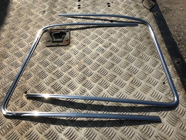

I've recently managed to pick up a good condition Stainless Finisher/Spreader for the rear window rubber on my recently purchased Hardtop (Photo attached).
Can anyone advise the best way for me to fit it without damaging it!
I can see that it overlaps the window rubber on the outer edges and then slots in via a flat section on the inner edges of the window rubber?
My thoughts where to leave the perspex window/rubber in place on the hardtop and then start at the corner on the outer edge, possibly using a length of cord or thin rope to space out the rubber to allow the edge of the trim to overlap the rubber and locate.
Then gradually remove the cord as the trim locates applying gentle pressure and easing out the inner section of rubber seal over the inner flat strip of the finisher/spreader at the same time to fully locate it?
Hope this makes sense.
If anyone can offer a better method, please let me know
Thanks

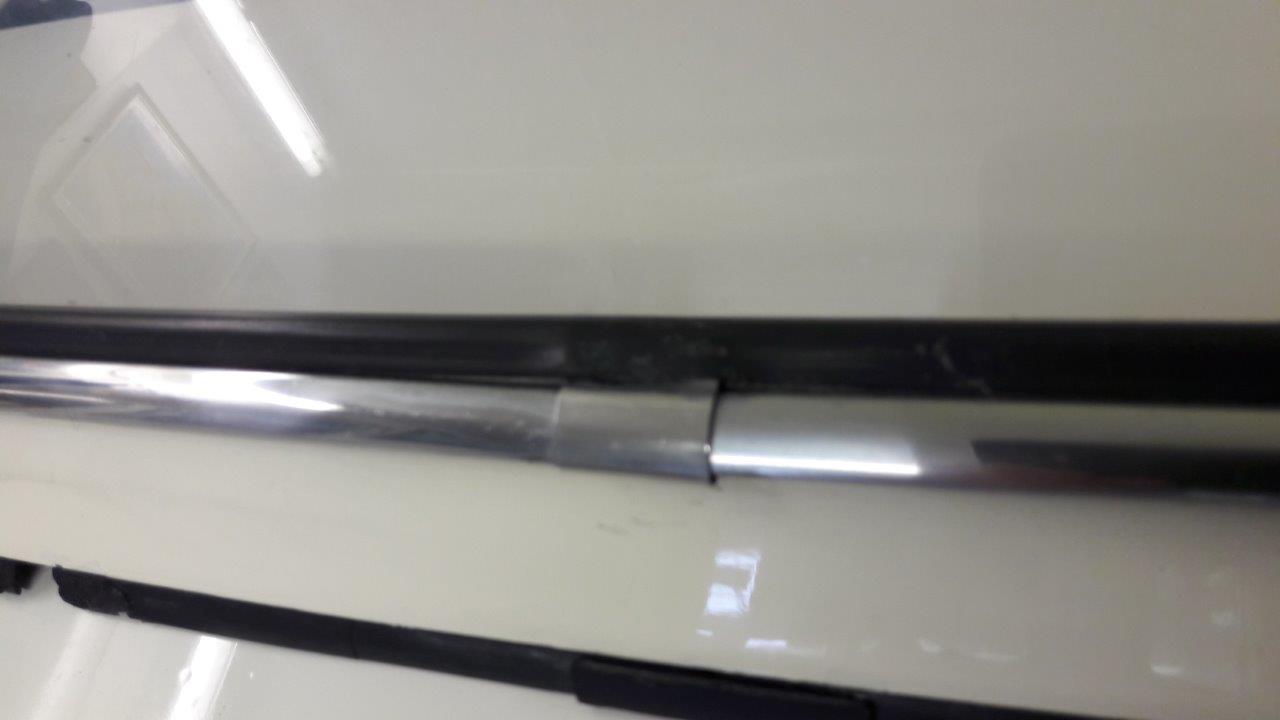

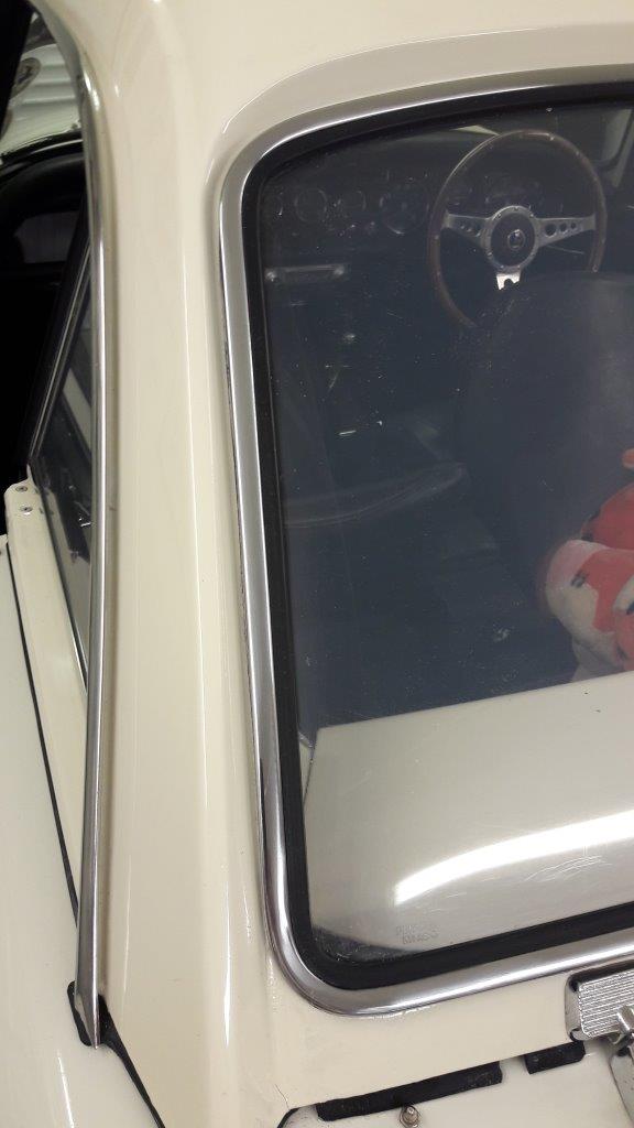

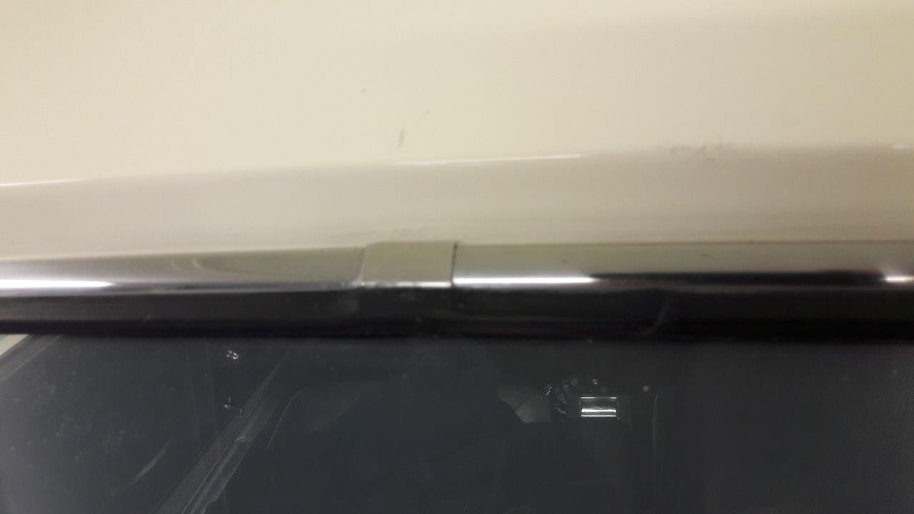

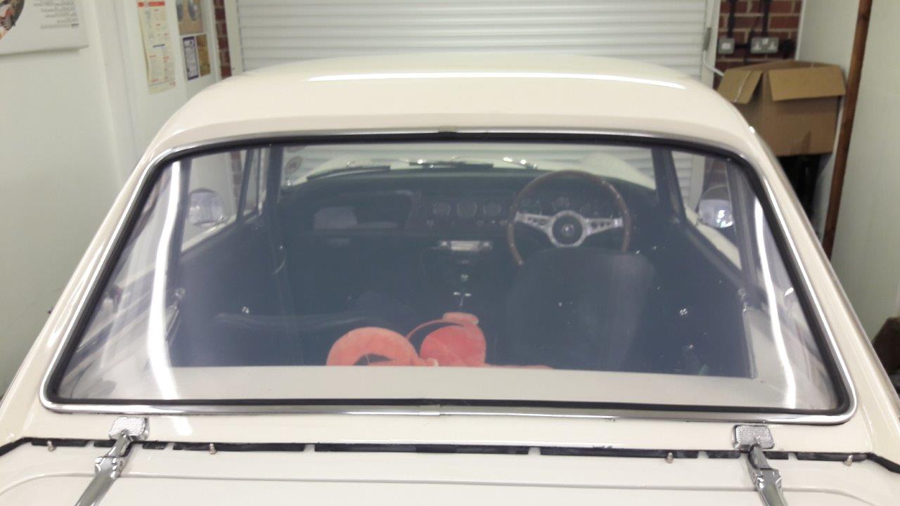

I finally got round to fitting the Stainless Spreader/Finishers to my car at the weekend, it was a job I was dreading but managed to complete the fitting in just over an hour much to my surprise with the rear window and seal still fitted to the car?!!
I used some small diameter electrical cable placed in the retaining slot of the rear window rubber to help locate the Spreader/Finisher, starting at the top corners I was able to ease the stainless spreader into position whilst pulling out the cable.
Copious amounts of soapy water helped to ease the rubber over the flat edge of the Trim.
The hardest parts to fit were the two Joint clip/covers, these needed a slight tweak to ensure a close fit and also a few drops of Superglue to hold them in place to the window rubber, hopefully the Glue will hold?
After further advice on Facebook pages I have also drilled the end of each Finisher top and bottom and tied the sections together using a small paper clip to try and hold them in place this was tucked in neatly under the Joint cover/clip.
A few photo's it looks loads better, just waiting a couple of lower corner seals to arrive in the Post and I will then replace all the lower seals as for some reason the main lower seals been cut in several places no Idea why?

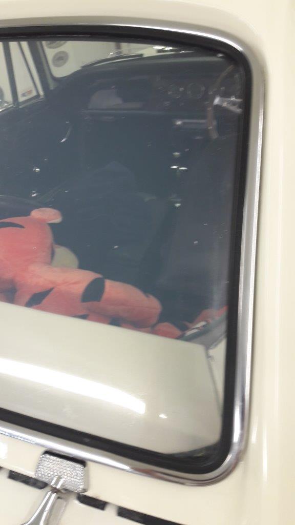

A couple more photo's.

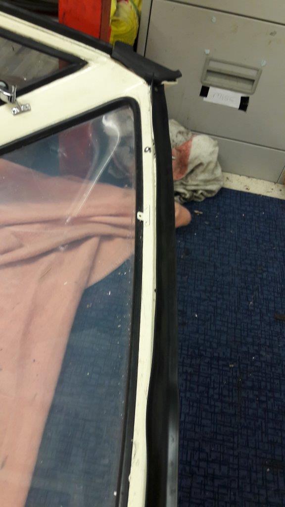

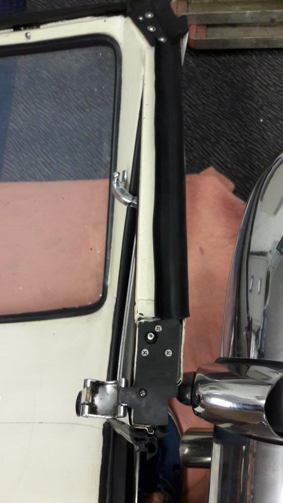

The Final installment on the Hardtop refurbishment (For now?)

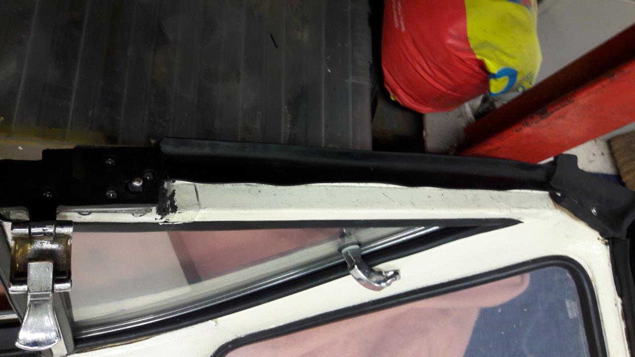

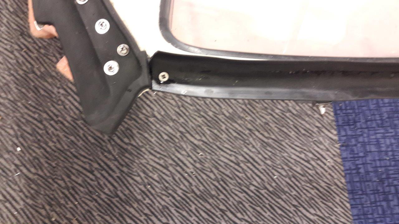

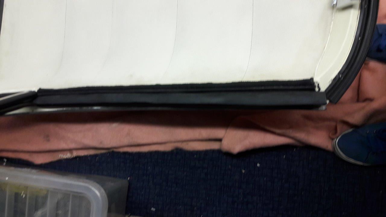

I Received all the lower seals and fitted them this week, including new seals to the top of the Door Windows on the Hard top.
The worst one to fit was the lower section under the rear window, plenty of lubrication, use of a blunt wood chisel and patience saw it fitted in just over an hour, I have secured at each end with a small countersunk self tapping screw.
I have also used some gasket paper to space out the 'B' Post seals as the catches were quite loose, hopefully they will be a bit tighter now although I've yet to fit the top.
I've also used the gasket paper to space out slightly the two pin brackets that engage in the holes in the Boot hinges, in a effort to try and get the pins to engage in the holes a bit more securely, will see how it fits over the Bank holiday?
A few Photo's
A few Photo's
