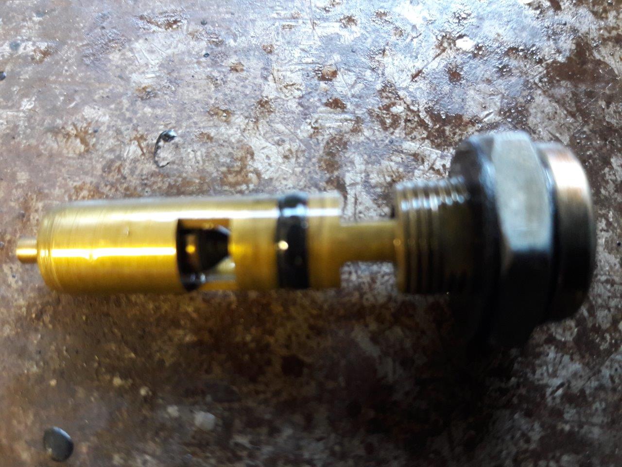

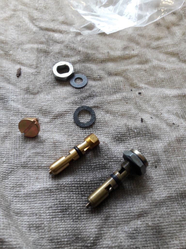

So I decide to remove the Needle valve to check it (Photo attached) I couldn't see anything jamming it and after a good spray of Carburetor cleaner it seemed to be shutting off correctly, the only thing that looked a bit iffy was the sealing 'O' Ring looked a bit shrunken?
After draining and changing the Engine oil and on replacement of the Needle valve the car started up 2nd turn of the key, ran on all 8 and was ticking over as smooth as ever once warmed up.

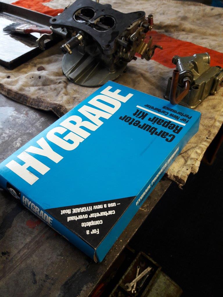

I finally Managed to pluck up the Courage to have a look at my Over fuelling problem recently, removing the 2 Barrel Holley Carburettor was straight forward, Air cleaner off then disconnected the Throttle and Choke connections, removed the Vacuum advance and Fuel pipes and blanked off the Fuel pipe.
Then 4 bolts to undo connecting the Carb to the Inlet Manifold and off it comes.

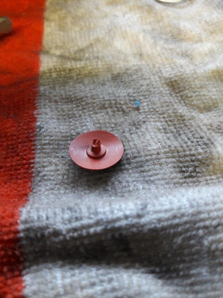

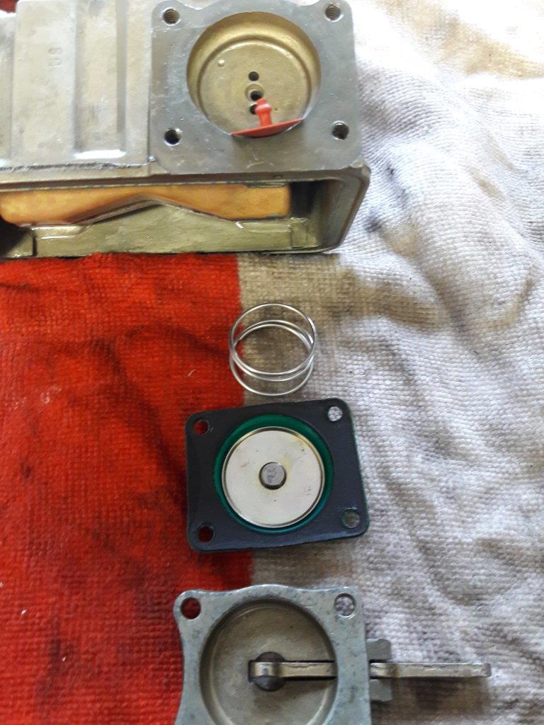

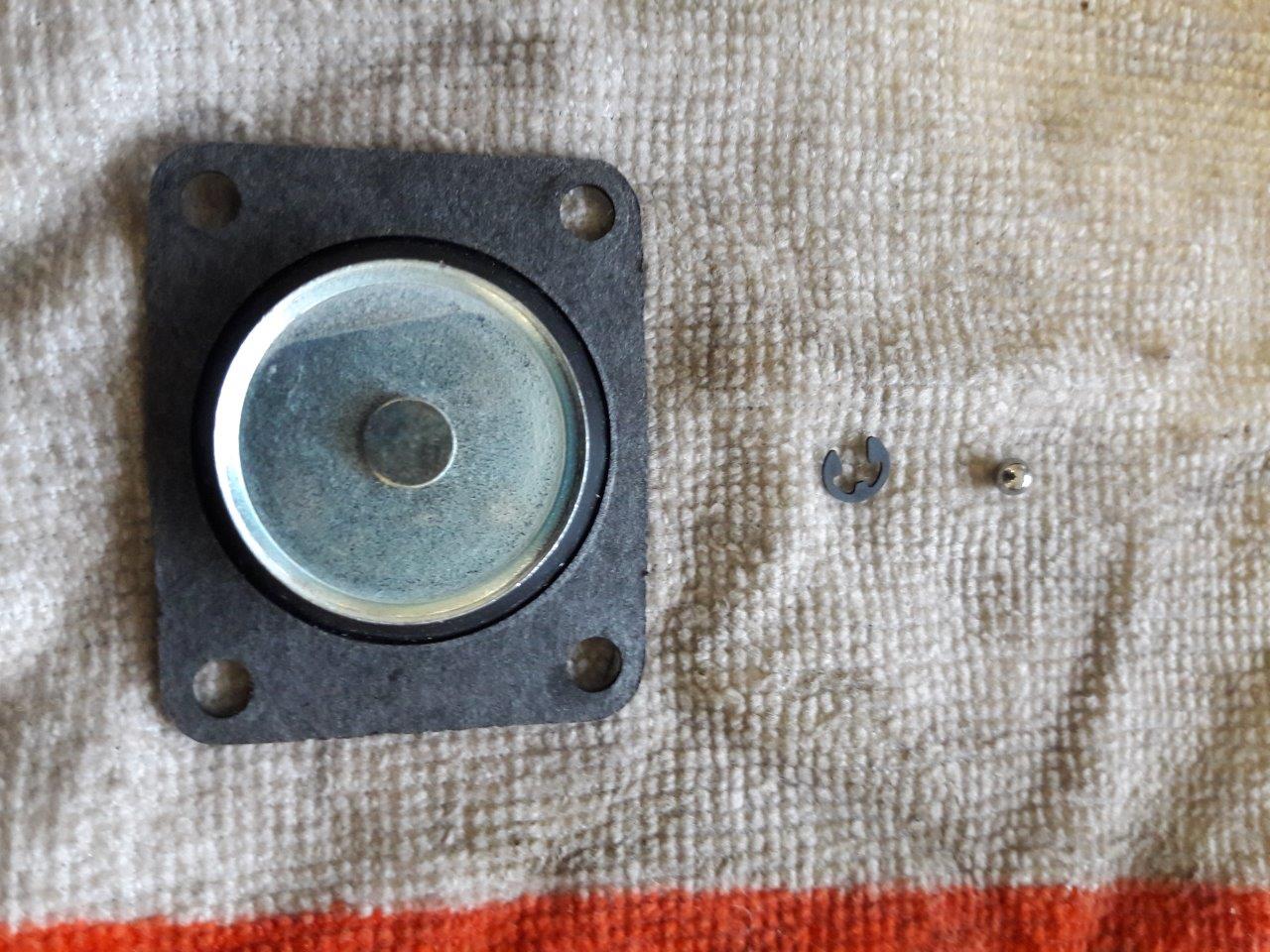

I had purchased a rebuild kit via Mustang Maniacs to suit this carburettor, however on strip down I found a problem with the Accelerator Pump parts.
In the Kit I had purchased you get a small ball bearing and retaining clip that fits under the Accelerator Pump Diaphragm, however my car is fitted with a Top hat rubber type blank, I've subsequently found out this is called check valve?
A quick E-Mail to Mustang Maniacs and they tell me this part isn't always in the kit!
Anyone I managed to source a couple of new ones for a few Pounds off a company called Customville American, a quick call and I got them via the post the next day, thanks Russ :D
So that's a job for the weekend to fit the Check Valve and then reassemble the Carburettor and refit it, I've already stripped it down and fitted new Power Valve, Needle Valve and cleaned up all Fuel ways and all mating surfaces, new Gaskets are in the kit.
I'm going to remove the Brass Float and check its not holed, I've not seen anything obviously wrong with all the old parts I've removed, no perishing of any rubber components on the Accelerator Pump Diaphragm or anything a-miss with the Power Valve. The only thing that looks a bit iffy is the Needle Valve sealing rubber seems to have shrunk, could this have been letting fuel by and over filling the Fuel Bowl maybe?

Some more photo's
6. Needle Valves.jpg (135.76 KiB) Viewed 49440 times

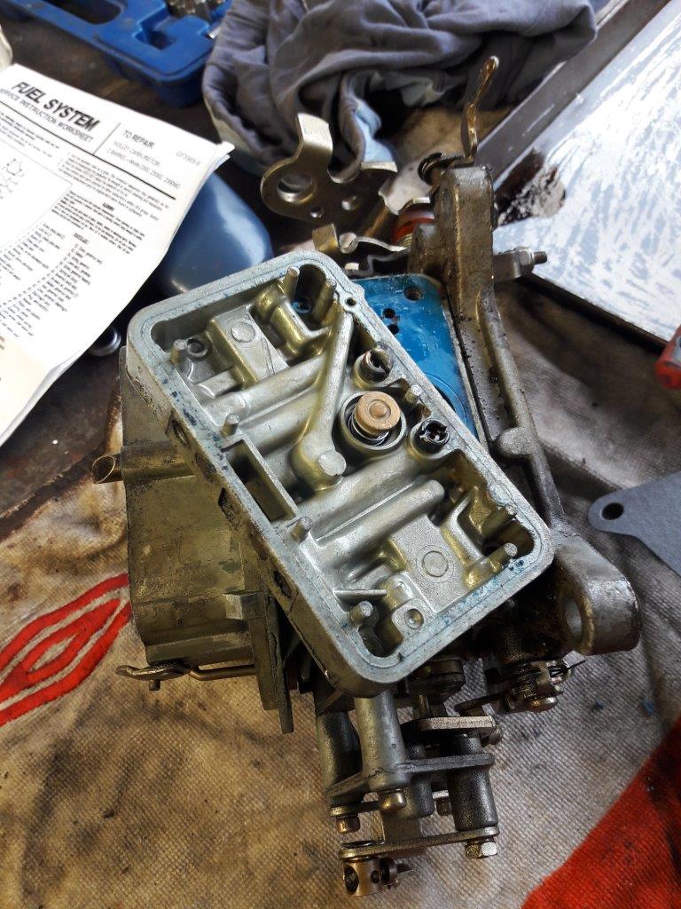

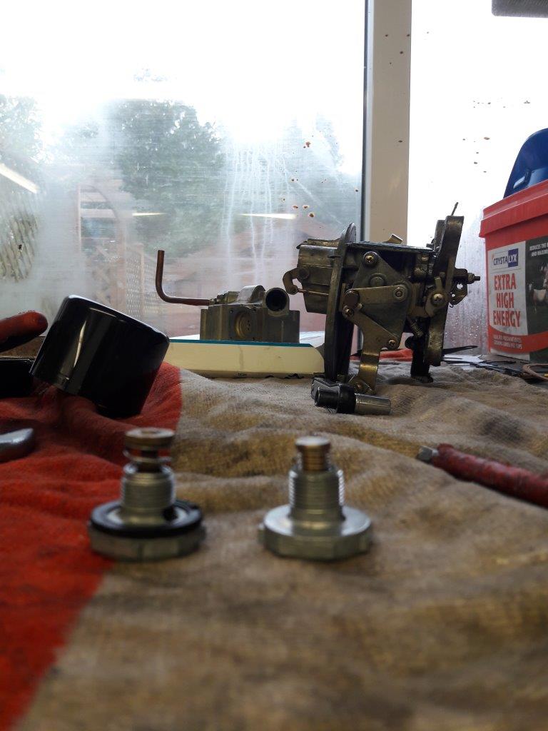

Post by garyf » Tue Feb 09, 2021 4:34 pm
Valve block and Power Valve
3. Valve Block.jpg (160.28 KiB) Viewed 49440 times

As stated previously, I didn't find anything obviously wrong with any of the components I've changed apart from the shrunken 'O' ring seal on the old Needle Valve, this could possibly have been the problem all along, with it letting fuel by-pass the valve causing over-filling of the Fuel Bowl, with the overflow dumped into the inlet manifold via the overflow.
