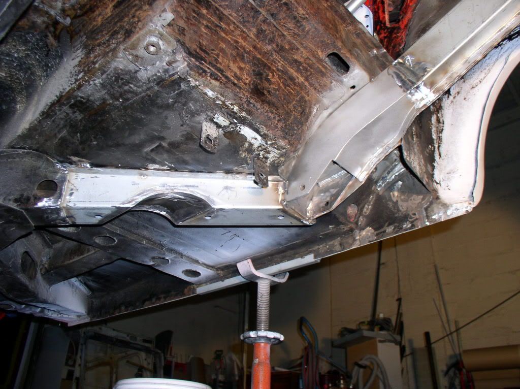

This side welded in. Still needs to brace through to the sill. Enlarged scollops for the exhaust
He has made patterns for the rear rails, so he can make more. But you need to take out all you see to fit them.
